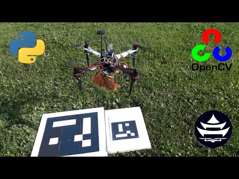

Well, the same concept applies for drones. What if you wanted to add some higher functionality into your drone that isn’t supplied out of the box, like gesture control, computer vision, python control, 4G drone telemetry, taco delivery etc?
Autonomous Drone Delivery | Taco Copters and Precision Landing
That is where the companion computer steps in. This is the device that we can use to introduce new functionalities onto our drone.

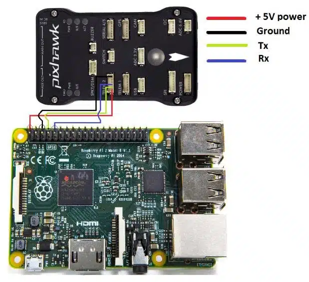

Flight Controller Vs Companion Computer
The most common example would be a pixhawk flight controller with a raspberry pi companion computer.
All the drone hardware wries into the flight controller like normal, but then you simply wire together your pi with the pixhawk.
The communication bridge can be done in many ways, but most commonly is performed through a UART bridge.
UART Bridge On Companion Computer To Flight Controller
Once the UART bridge is created, the companion computer can send over high level flight commands to the flight controller to be controlled in new/unique ways.
For example, let’s say you wanted to land a drone on an aruco marker through computer vision and a camera.
The breakdown looks like this.
  1. Plug a camera into the raspberry pi
  2. Write a script on the pi to look for the aruco marker with openCV
  3. Determine how far away the camera is from the marker
  4. Send a flight command from the Pi to the Pixhawk to adjust over the marker
In step 4, you’re essentially treating the Pixhawk as an API. Through 1 line of code on the companion computer, you may be commanding the drone to fly a bit north.
The flight controller then accepts this input and taps into the 100’s of lines of code that is required to physically move the drone’s hardware to satisfy the command.
But from the companion computer, all you needed was one line of code. The flight controller has no idea that there is some other board running computer vision that is generating flight commands. It just accepts the flight commands and is agnostic to the source.
