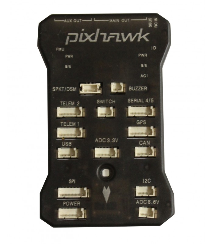

It is easily flashable onto popular flight controllers like the Pixhawk. So in seconds, you can obtain all the features of the very complex firmware.
You may be tempted to write your own firmware for your special robot, I wouldn’t recommend that. The ArduPilot code base has millions of lines of code for sensor integration, position estimation, sensor drivers, control modes, safety features and a ton more. It’s just not a productive use of time to reinvent the wheel.
ArduPilot for the rover and boat vehicle types is called ArduRover, and is what we will be using on this build.
ArduRover and the Pixhawk alone are capable of autonomous driving.Â

To really unleash to power of your smart rover, you’ll need to install a companion computer. For this build, we will be using the Jetson Nano to put our smart rover on steroids.
It will communicate with the Pixhawk, running ArduRover, via a UART connection. Once this UART connection is established, so much is possible.
