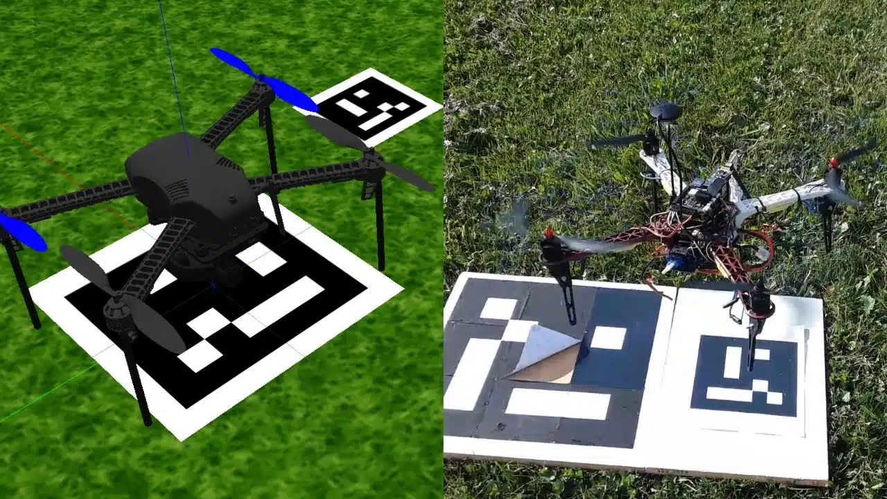

Computer vision testing right on your computer. That is what we did in our taco delivery mission, where we needed the drone to precision land on an aruco marker array.
Autonomous Drone Delivery | Taco Copters and Precision Landing
We first wrote the code and proved it out in the simulated world. This allowed us to RAPIDLY debug the openCV taco delivery script. I honestly estimate the time to complete this project would have been 100x if the openCV drone testing had to be done exclusively on the actual drone.
Once the script was working on the Gazebo drone, it was ported over to the actual drone and get this.. it worked!
Watch this video to see the Gazebo precision landing, followed by the actual drone performing the same script.
Precision Landing a Drone on an Aruco Array
