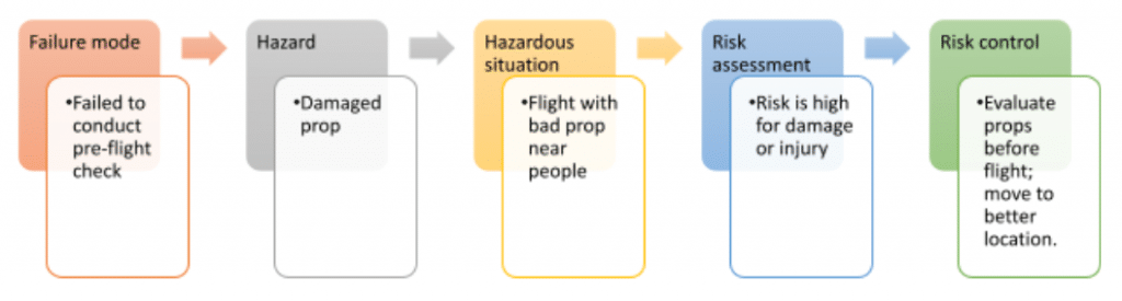

This can be diagrammed as follows (with example).
For example, using an unsecured prop is a hazard. Flying the drone near people would be a hazardous situation since the prop could fly off and the drone would crash. The risk then would depend on the probability of the drone crashing, causing injury or damage. Flying at a large empty field would be significantly less probable of causing harm than flying near obstacles. Conducting a pre-flight inspection would exclude a bad prop.
