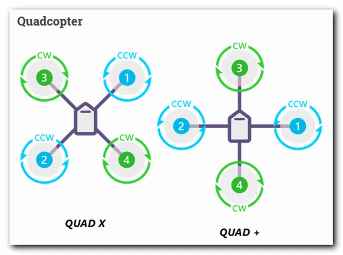

Common reason #1: Wrong motor and/or prop placement. Each copter design requires the specific placement of either clockwise (CW) or counterclosewise (CCW) motors. These motor types differ by the type of shaft that accommodates either CW or CCW props. Proper motor placement is illustrated by maps for each design type. Improper placement of a motor or/and propeller is almost guaranteed to cause a flip.

Motor order for quadcopter frame type and class

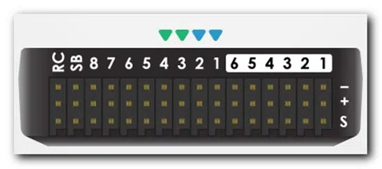

Common reason #4: Wrong esc signal wire to the flight controller. Placing the esc wire in the wrong servo slot or in the wrong orientation will be a problem. For example, in the Pixhawk the ground (-) wire is up and the signal (s) down. An easy trick to avoid a mix-up is to place one dot for motor 1, two dots for motor 2, etc on each esc wire.
Pixhawk Output pins showing color coding for CW and CCW.

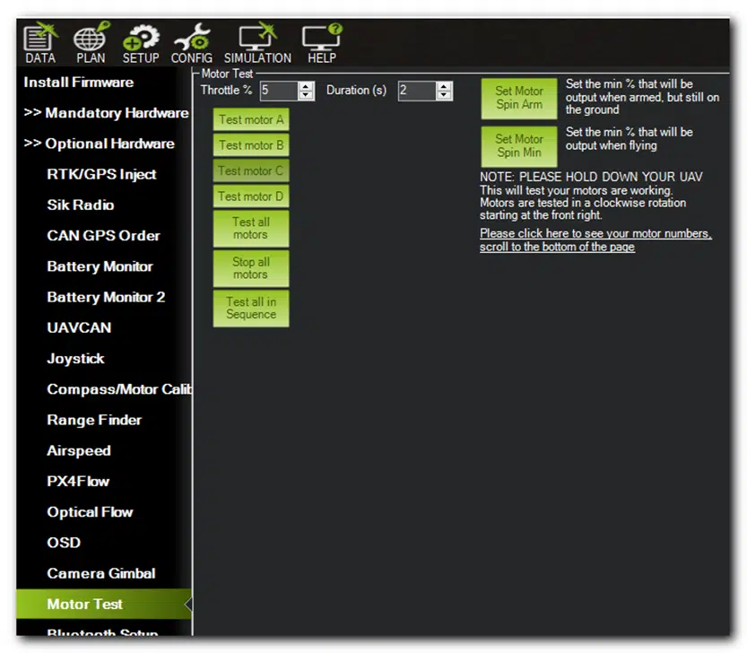

At this point, the Mission Planner ‘Motor Test’ (SETUP>Optional Hardware) offers a convenient method to check if each motor is spinning properly. Power the drone with a charged battery and connect with telemetry to run through the options.
Mission Planner Motor Test

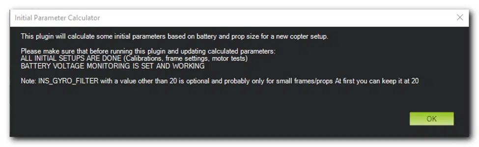

  • Use Mission Planner ‘Alt-A’ for initial tuning. This will provide a good first estimate which can be updated with other tuning methods.
Mission Planner Initial Parameters Feature

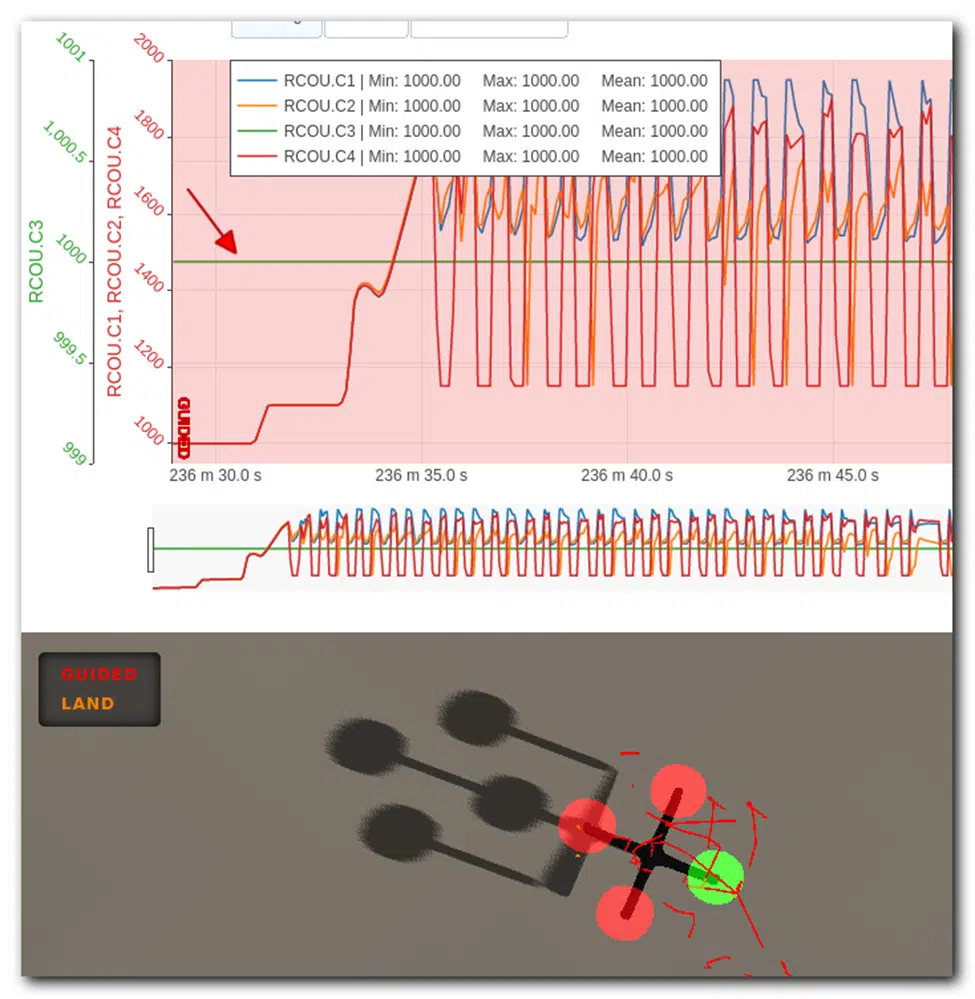

Copter Takes A Flip: Simulated Loss of Motor 3 (red arrow)

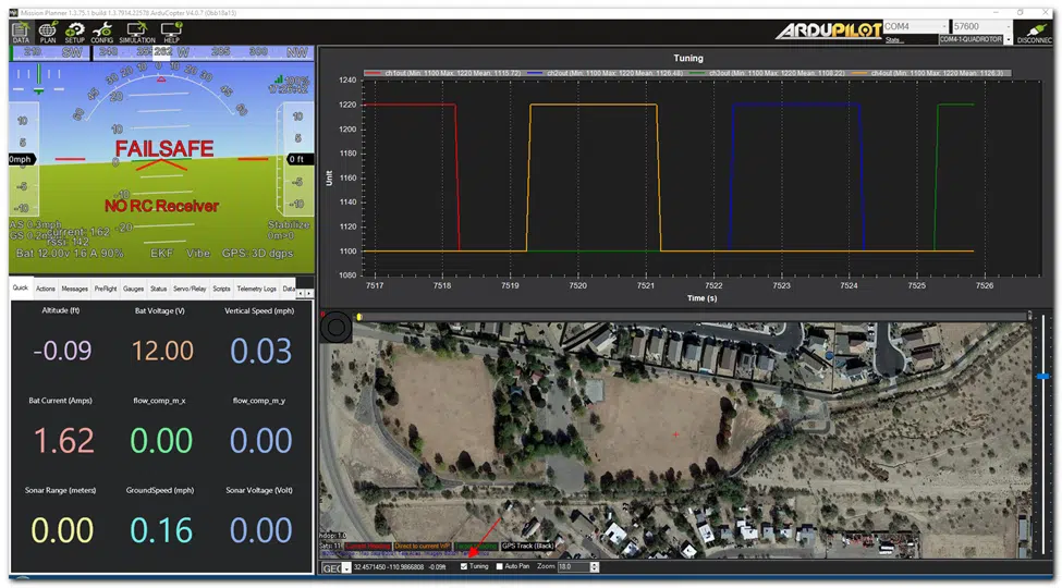

Use the Mission Planner Tuning feature to evaluate the drone. Under DATA check the bottom Tuning box. This can be used while running the Mission Planner Motor Test to see if there is a signal when a motor is not moving.
Mission Planner Tuning Tool (red arrow)
