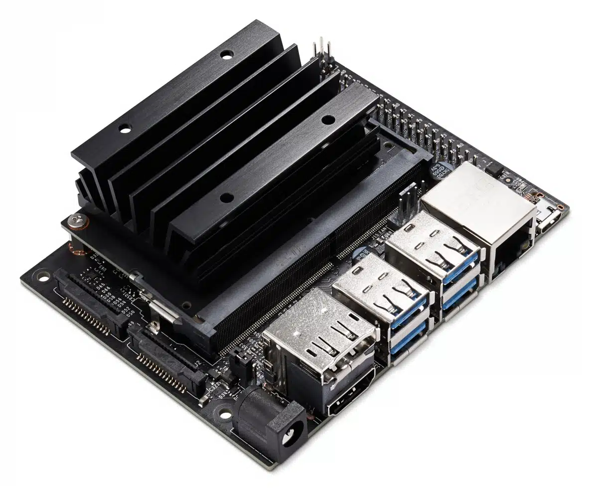

Most advanced DIY drones consist of a flight controller to command the low level hardware, and a companion computer to program in custom functionality.

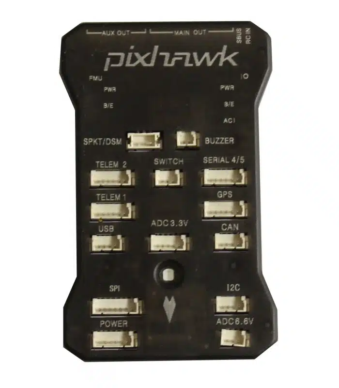

For example, a flight controller like the pixhawk sends commands to the motors to balance the drone. While a companion computer, like the Jetson Nano, can attach to a camera with object detection and send flight commands to the flight controller to track an object.
Pixhawk Flight Controller
Both are needed for advanced missions, because the companion computer isn’t dependable enough to write commands to the flight controller. The CPU would prioritize other tasks not related to flight, and the drone may fall out of the sky.
For this reason, we drones need both a flight controller and a companion computer.
For flight controllers, the pixhawk flight controller is the perfect blend with performance and affordability.
