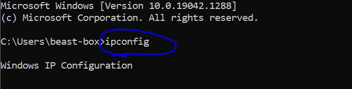

2. On your desktop computer, go to the search bar and type “cmd”
3. Click on “cmd” then type “ipconfig” and hit enter

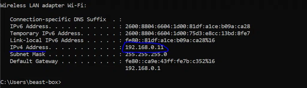

4. Make note of the IP address under “Wireless LAN adapter Wi-Fi”
So the IP address of my desktop running MissionPlanner is 192.168.0.11

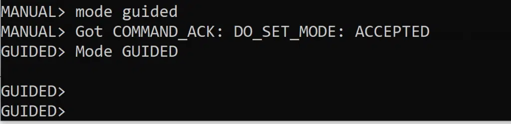

6. To prove we have a connection to the drone flight controller, let’s change the flight mode. Type the following:
mode guided
If the flight mode changes to GUIDED, you have a successful connection.

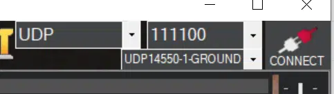

9. Now open MissionPlanner. It may already be connected to your drone (if Altitude is changing on the home screen you’re connected).
If it isn’t connected go to the top right of MissionPlanner, and select UDP from the drop down and click connect
Enter in 14550 as the port number that MissionPlanner should be listening on and hit OK
You have now connected your MissionPlanner to the drone with the internet!
