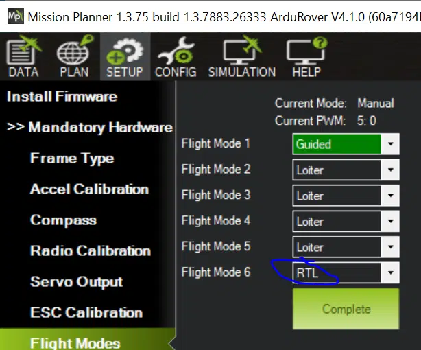

4. Make sure you are familiar with the flight modes that are active.
Ensure the last flight mode on your flight mode knob is set to “LAND” or “RTL”
Then you can switch to emergency LAND or RTL quickly by rotating flight mode knob all the way to the right

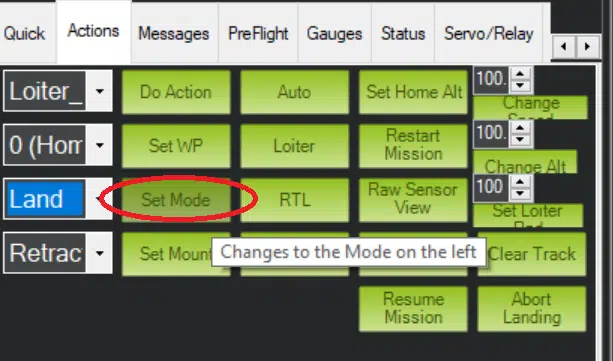

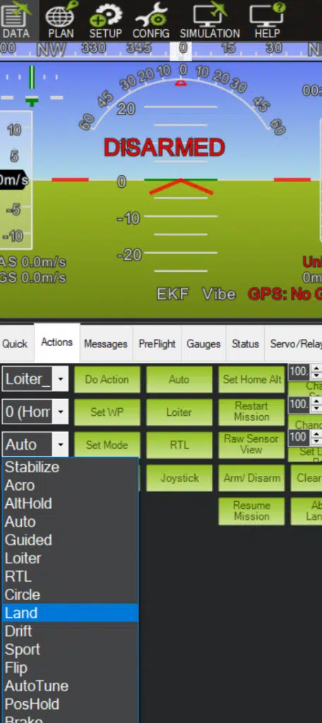

5. In MissionPlanner, to go “Actions” tab.
In the dropdown, select “LAND”.
In case of emergency and the drone is flying away, click “SET MODE” which will trigger the drone to land.

9. If at any point the drone becomes unresponsive and flies away, rotate flight mode knob all the way to the right to trigger “LAND” mode.
If this is unresponsive, click “SET MODE” in MissionPlanner to set mode to LAND through telemetry.
